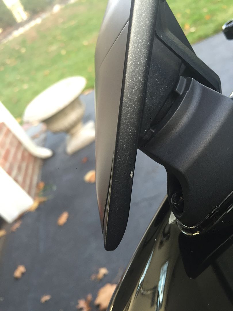

I know a few guys have had the same problem & used a sharpie on this area:

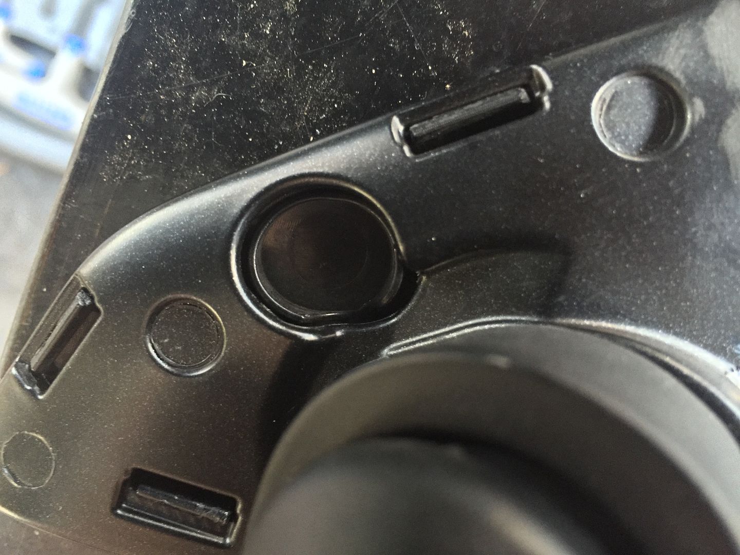

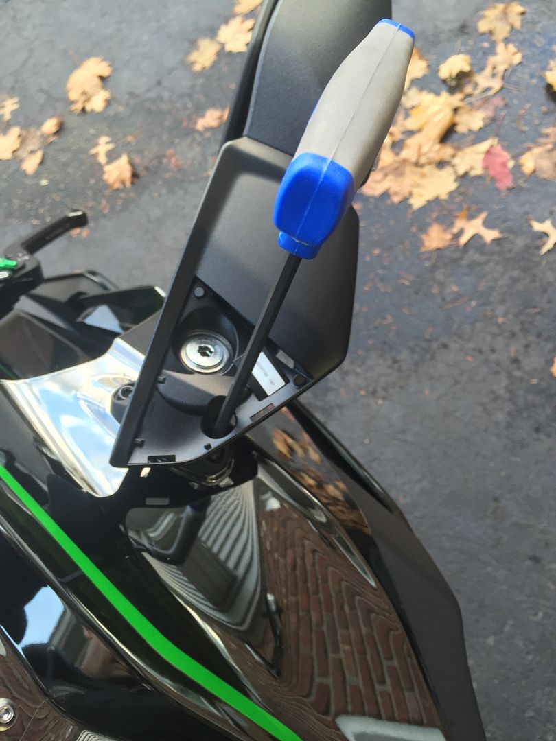

Dunno if this has already been discovered/posted but today stumbled across how the mirrors were actually engineered to be removed and installed without scratching the arm. Under that plate on top there is a small opening perfect for your finger to fit through, you just push it which releases the clips and plastic cover and using the same hole like magic (lol!) it's a straight shot w/ the hex to the bolt. Guess they did think of everything.
