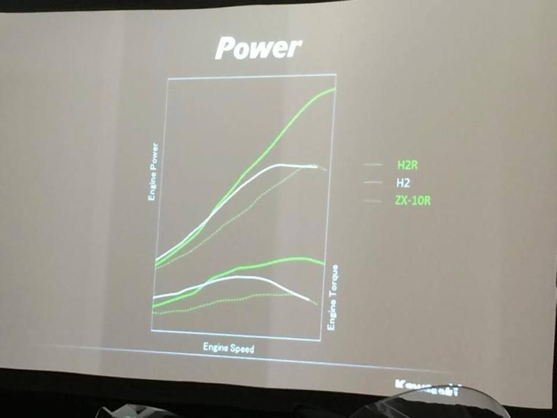

You can even see this in Kawi's presentation, even though the revs are rising, the bike doesn't make additional power, interesting as well is (cam + compression) stock H2's make more HP & TQ then the H2R in the lower revs:
