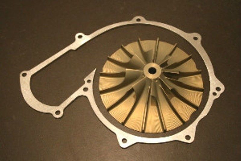

The following information regarding the KHI-DESIGNED SUPERCHARGER is absolutely IDENTICAL in BOTH the 2015 Kawasaki Ninja H2 AND H2R Press Releases (U.S.).
 The supercharger is driven by a planetary gear train, which runs off the crankshaft. Designing the gear train using technology from Kawasaki’s Aerospace Companyresulted in a compact unit with minimal power loss.
 The gear train increases the impeller speed up to 9.2x the crank speed (1.15x stepgear with an 8x planetary gear). This means at a maximum engine speed of approximately 14,000rpm, the impeller shaft is spinning at almost 130,000rpm.
 The impeller is formed from a forged aluminium block using a 5-axis CNC machine to help ensure precision and durability. The 69mm impeller features six blades at the tip, expanding to 12 blades at the base. Grooves etched into the blade surfaces help direct the airflow.
 The impeller’s pumping capacity is more than 200 liters/second (measured at atmospheric pressure), with intake air reaching speeds of up to 100m/s. After passing through the supercharger, air pressure is increased to as much as 2.4x atmospheric pressure (35psi). :nerd:

The sun gear (on the impeller drive shaft) has 14 teeth. The planet gears have 49 teeth. The ring gear is not shown, but because of the way gear teeth work, it has to have 112 teeth (2 x planets + sun). That is exactly 8:1 step-up ratio in the planetary gear set. The gears from the crank to the countershaft are not shown, but it looks like the countershaft gear is smaller than the gear on the crank by quite a bit. It's plausible that the real situation is a 1.31:1 step-up ratio (crank to countershaft), followed by the 0.88 (22/25) chain step-down, followed by the 8:1 planetary.
It's pretty unlikely that the crankshaft-to-countershaft ratio would be changed, because that would require changing the crankshaft since the gear is built into it, and that's expensive.
I'm now suspecting that they all have the same drive ratio - but there's no guarantee that they use the same impeller ...

Except the official Kawasaki Press Releases (U.S.) for both the H2 and H2R state the exact same specs...
