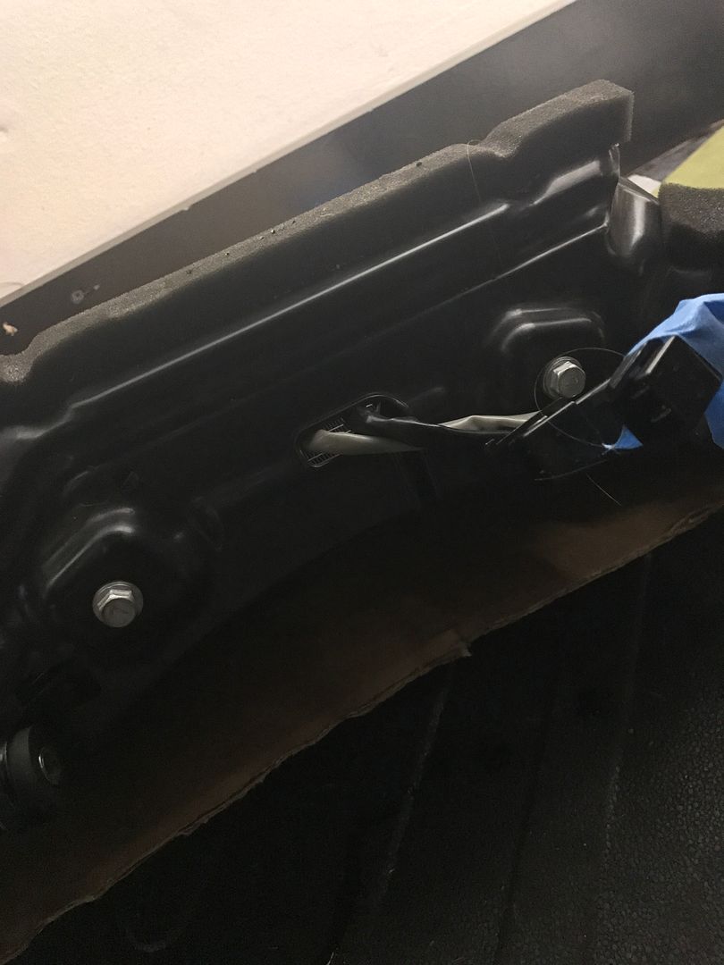

Do you have to remove the radiator?
My allen wrench hit the fans, and the inner fan bolt is inaccessible!
Grrrrr.
Best to remove the radiator plus I didn't see how I was going to get a torque wrench in there to torque down the new headers properly with the radiator there.
Not positive what you mean by "inner fan bolt". The main top/side radiator bolts look somewhat inaccessible but all you need a socket extension or for me they loosened w/ a screwdriver handle socket, the bolts are mounted/sit through rubber grommets so not in there super tight.
The top cover fan bolts, that hold the plastic cover - figure 11 in Brocks directions aren't accessible till you remove the side/top radiator bolts, lower bolt (by headers) & lower the radiator.... But I didn't bother to remove the top cover bolts. Drained the coolant (only comes out totally on side stand) , cleared the wiring in the harness on the left side (by where the front of the ram air tube goes) unplugged the fans, removed the radiator hoses & pulled out the radiator w/ the plastic top cover still installed.
I have a service manual, it helped but also says to remove the radiator you need to remove the gas tank to get at the air switching valve, a step I didn't go through.
The side/top bolts that are in this area (the bolt hole) need to be removed, they're accessible w/ a screwdriver handle socket or socket extension:
The bolts that are directly on top of the radiator that hold the plastic cover aren't accessible till you lower the radiator but in any case I didn't see a need to remove them:
