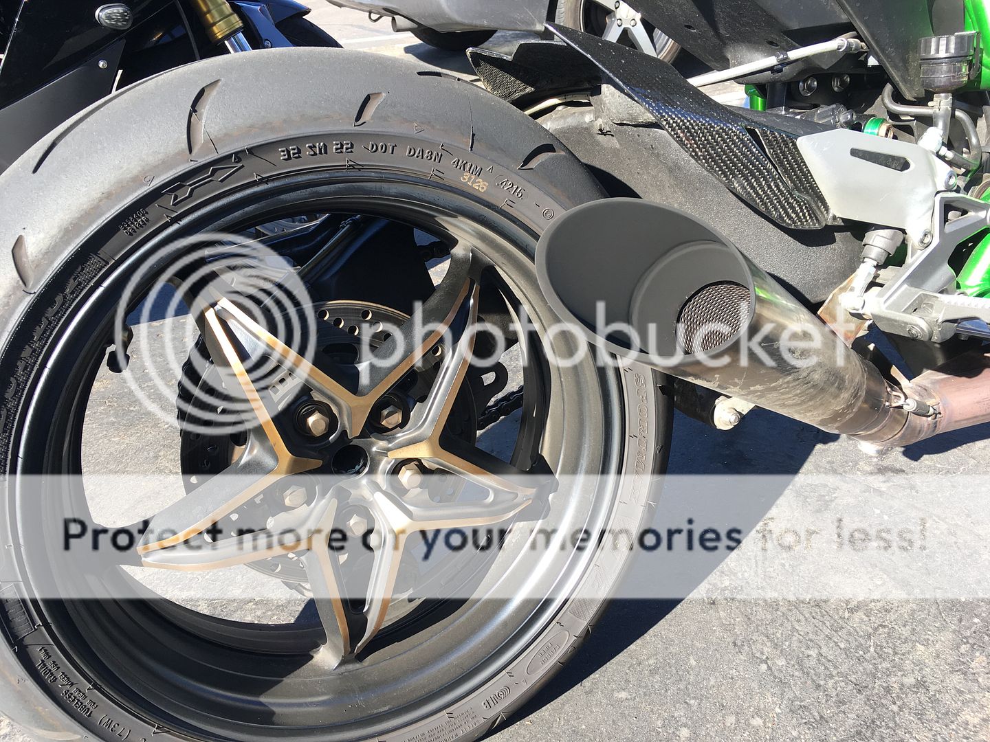

so I hooked up today with a '15 H5, I was checking it out and noticed that his stock rims were gold instead of silver. Pointed this out to him and he said no he hadn't painted them, THE PIPE TURNED THEM THAT COLOR! Holy Crap! Note the wheel nuts are gold too.. @Turbo329 beware, hope your new system doesn't do this too.

The gold looks to perfectly evenly distributed for me to believe it was done by the exhaust.. if so, then that is pretty bizarre. Hope he doesn't mind! If you see him again.. tell him to wash his bike!! :p

Ha I was going to say the same thing, wash the bike it's disgusting, you may find its dirt and dust and clean wheels underneath that muck

What exhaust is that? Look at the carbon in there, looks a bit much. ...could write "wash me" in it

Yes, a short exhaust can do that to the wheel. It's happened to me too. To clean it up I use brake cleaner on a rag, and gently rub all the spokes until they shine again. Same for the bolts and also for the valve stem.

Can that grime be from one ride?
Looks like an H2 in need of some TLC to me.

It's exhaust fume/carbon that build up over time. It happens with a short style exhaust, and you have to clean it regularly, way before you reach the conditions showed in the pic.
Bike is not very well taken care of.
Happened to me from the short full exhaust, took about 4000 miles after the exhaust install to show & was only slightly yellow, could only tell in certain lighting, not anywhere near as bad as that pic & only to the silver accent areas of the wheel not the bolts. It's definitely from the exhaust because while looking closely noticed a slight yellowing to the right, rear turn signal lens above the exhaust too. Came off totally & very easily in seconds from the wheel w/ simichrome & from the directional lens w/ plastic polish....
In the case of that pic - Imagine never cleaning the bike isn't going to help.
