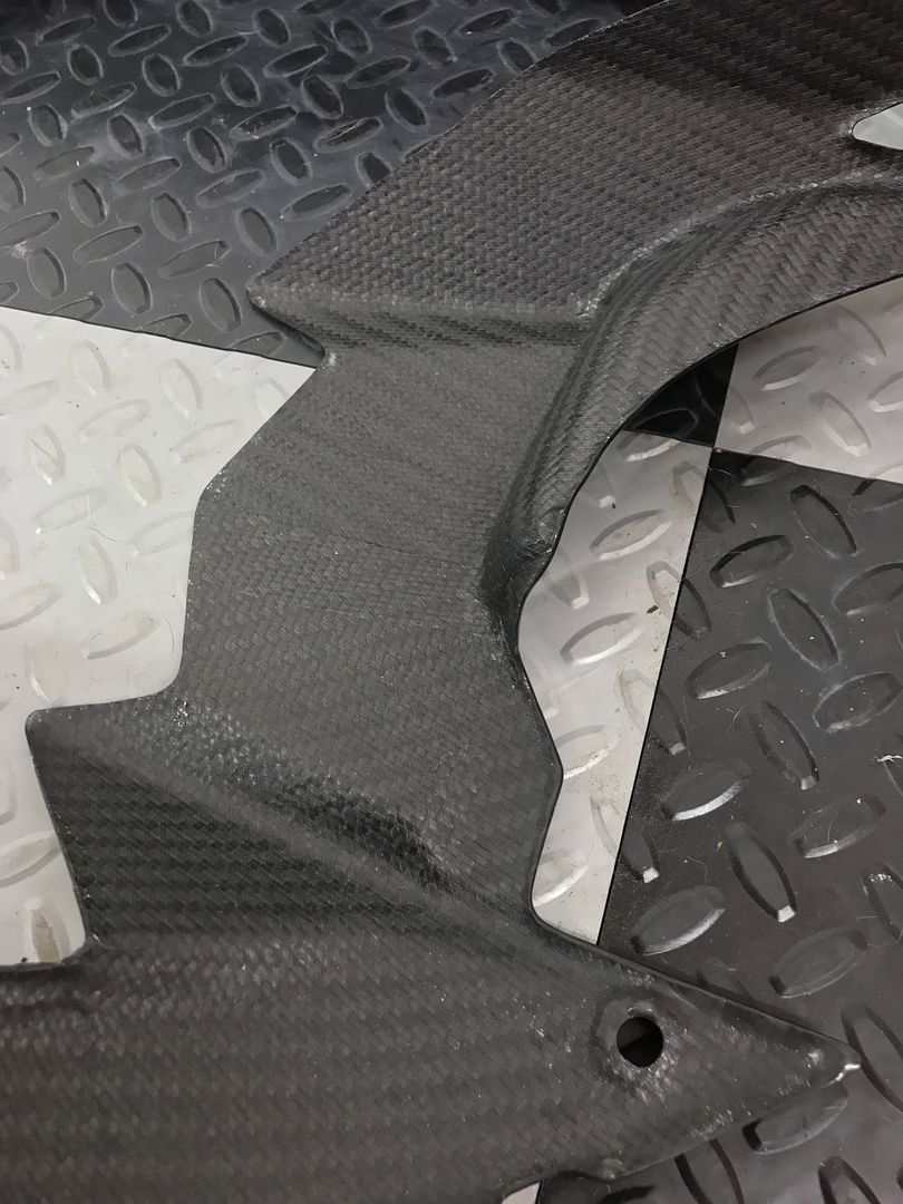

As people have seen Carbon Fiber is really difficult to buy online, the quality of carbon fiber ranges from the laminated fiberglass process to pre-preg, you can narrow down the suppliers that make pre-preg, there are only 2 co.'s (maybe a 3rd) that I know of for sure making parts for our H2 this way but it's impossible to tell/compare from pictures the actual quality. Even if they're using pre-preg quality can be all over the place. Fit is ultra important but so is uniformity/symmetry of the weave, clear coat quality, etc.
Sometimes how perfect the weave looks isn't important for certain racing parts or areas that aren't visible on a vehicle but that's not the case w/ CF parts for our H2's. The process for making bolt holes, angles makes it really difficult to make carbon fiber where the weave is symmetrical and without visible imperfections. Took me a few months to decide on the company I was going to purchase from but couldn't be happy with the stuff that Activemoto is manufacturing. The parts are made using carbon epoxy composite tooling, pressurized 100% carbon fiber Pre-Preg material, bladder moulding process at ~60PSI of pressure, using prepreg carbon only, and cured at 250F for several hours, followed by hard coating, UV PPG clear coat, and final polish. The weave is beautiful, the gloss clear coat is perfect.

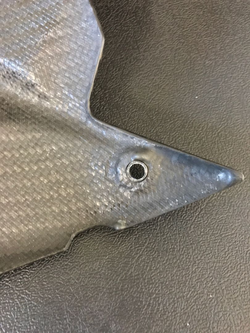

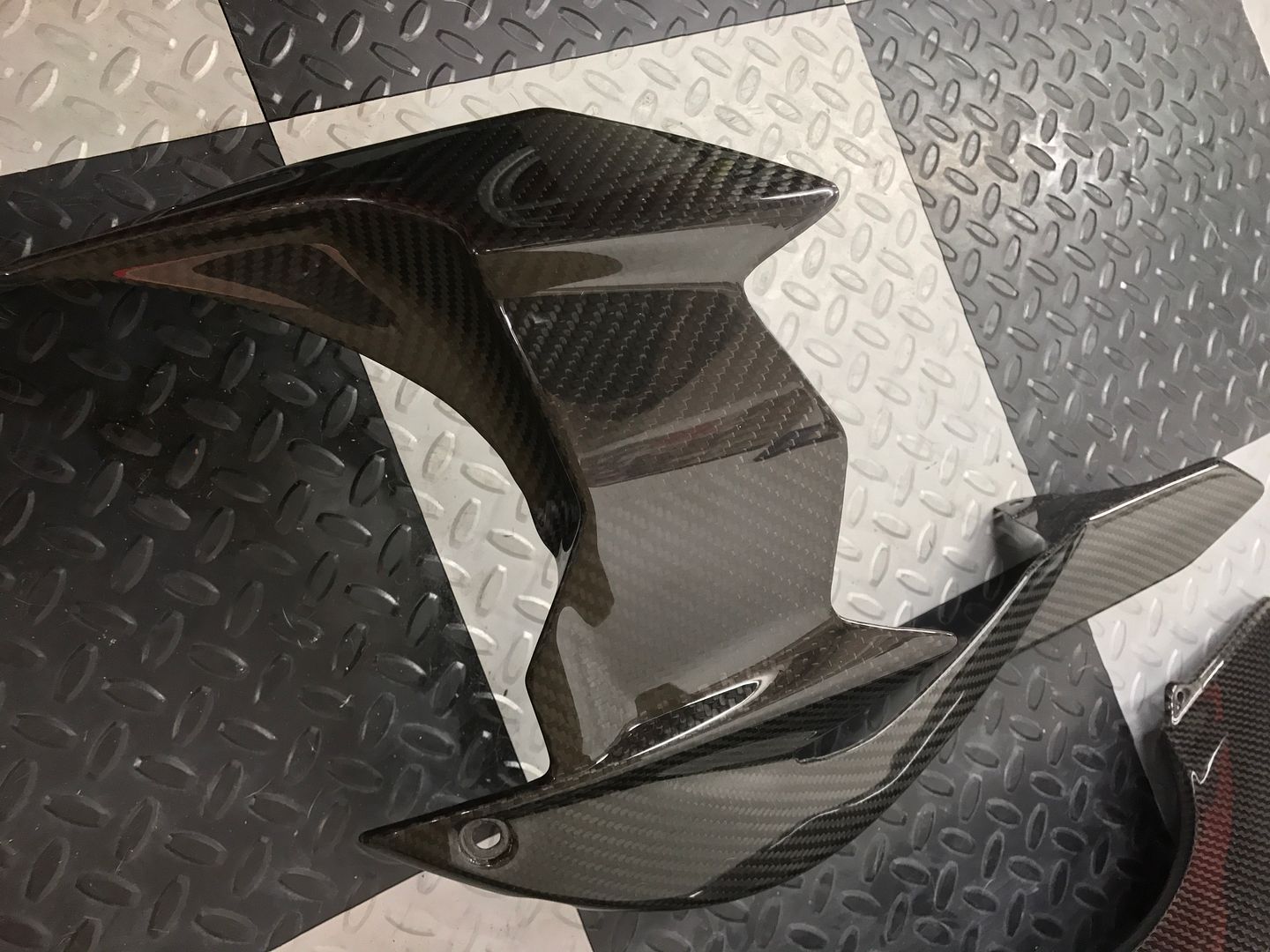

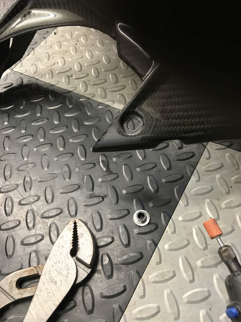

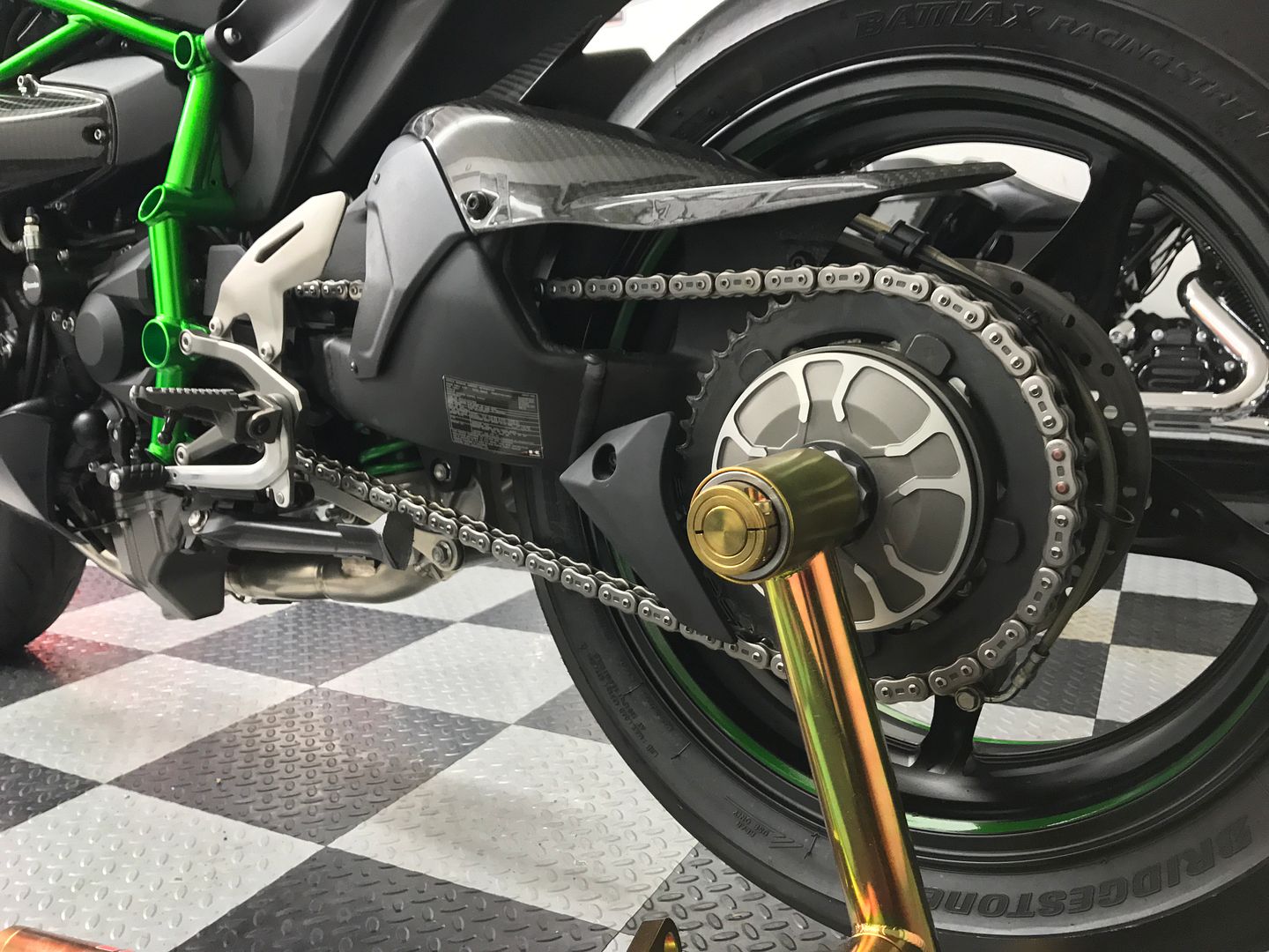

On the OEM chain guard there is a metal washer/spacer that bolts to the top left of the swingarm. The hole in the carbon fiber part was slightly too small for this spacer. I probably could have fit the carbon fiber part without the spacer w/ a regular washer or made the carbon fiber hole slightly larger but the spacer is a $3 part so dremeled down the size, a file would have worked too. Other than that fitment was spot on.

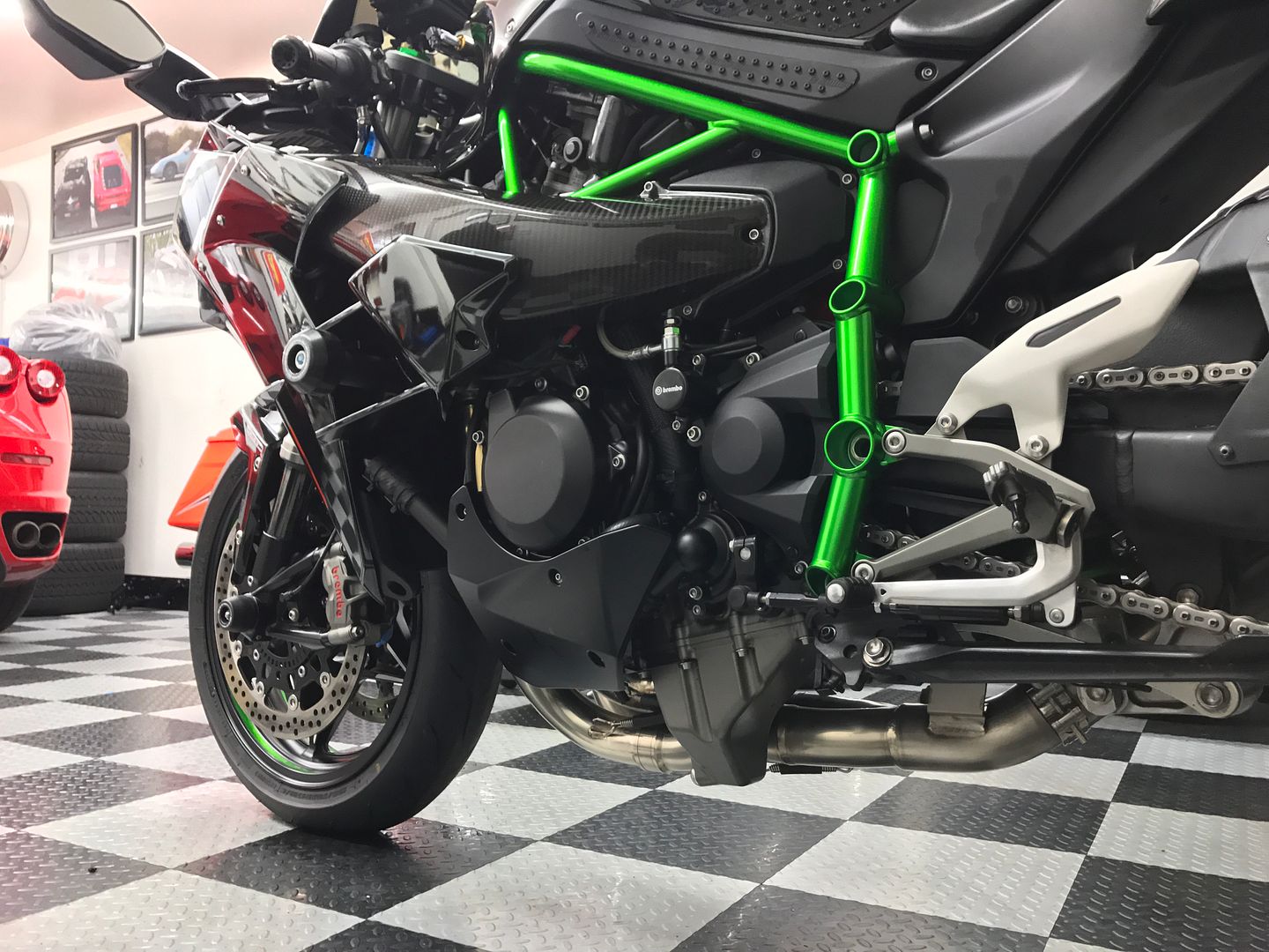

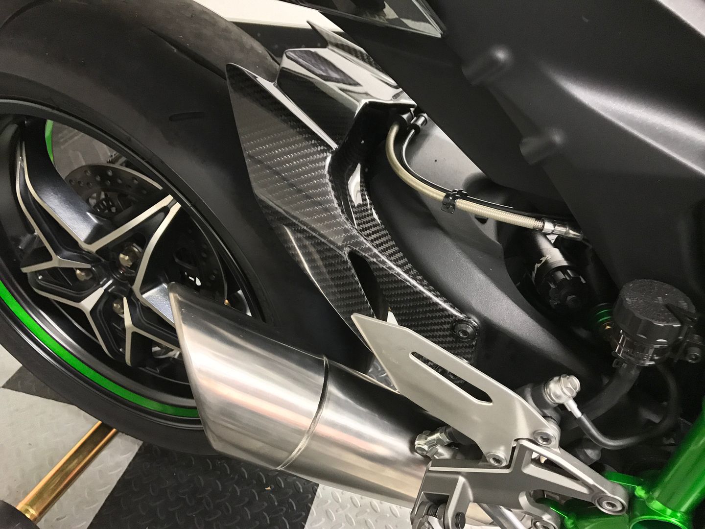

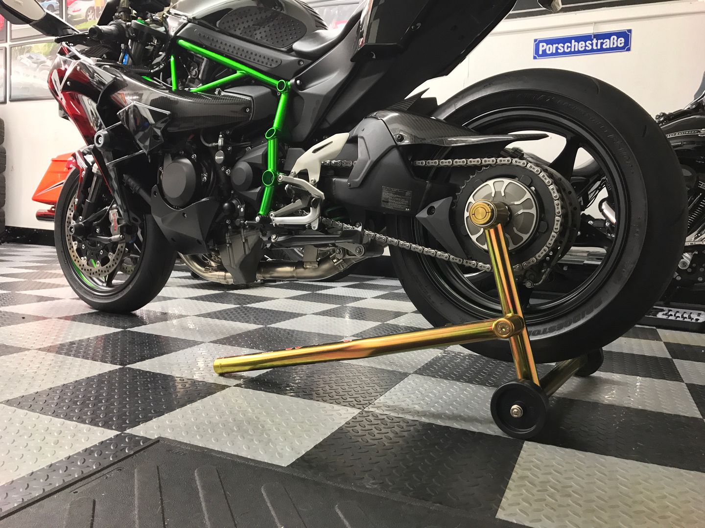

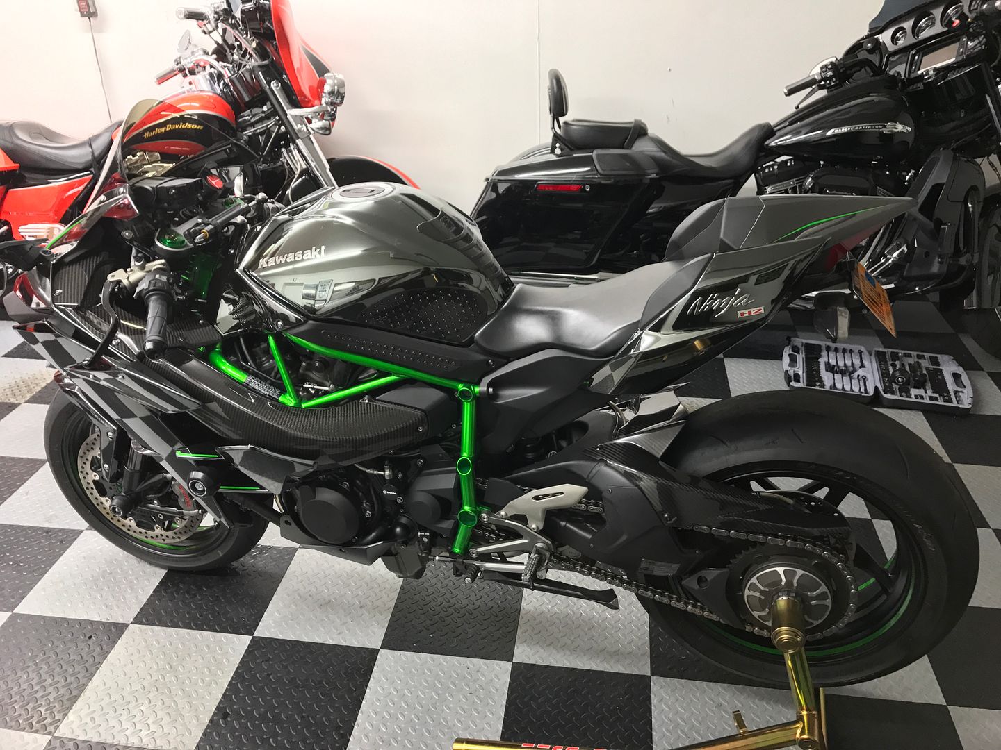

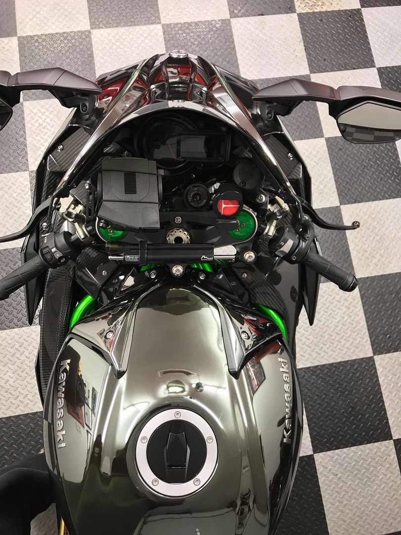

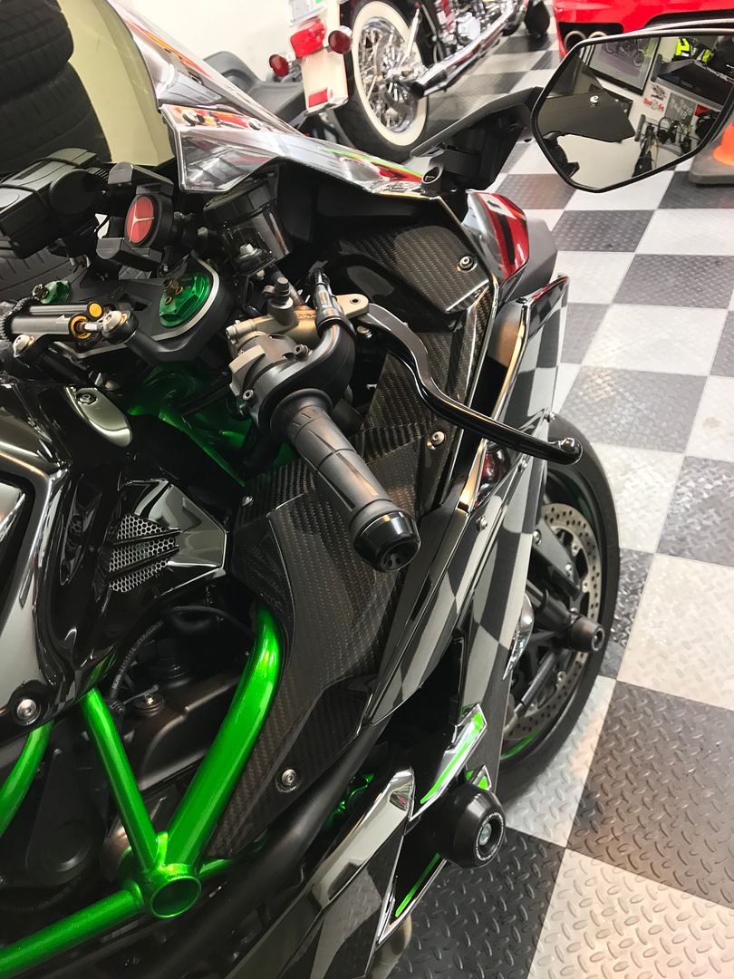

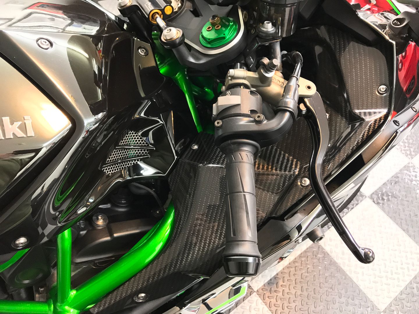

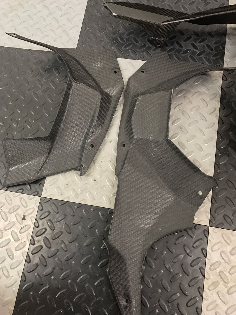

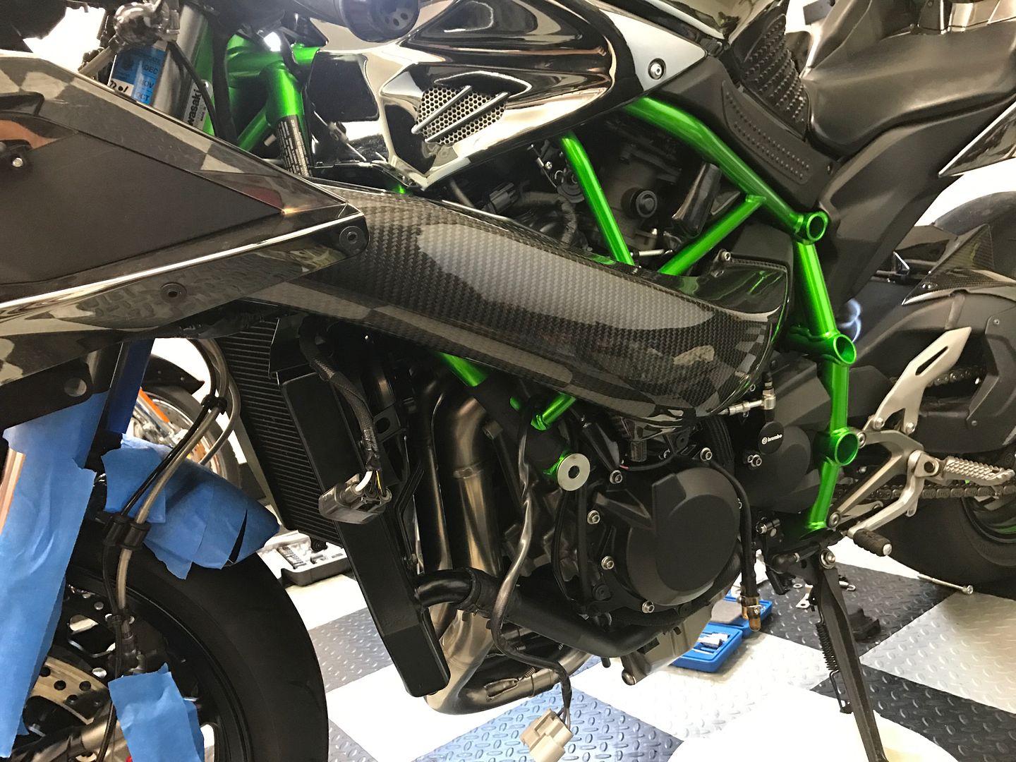

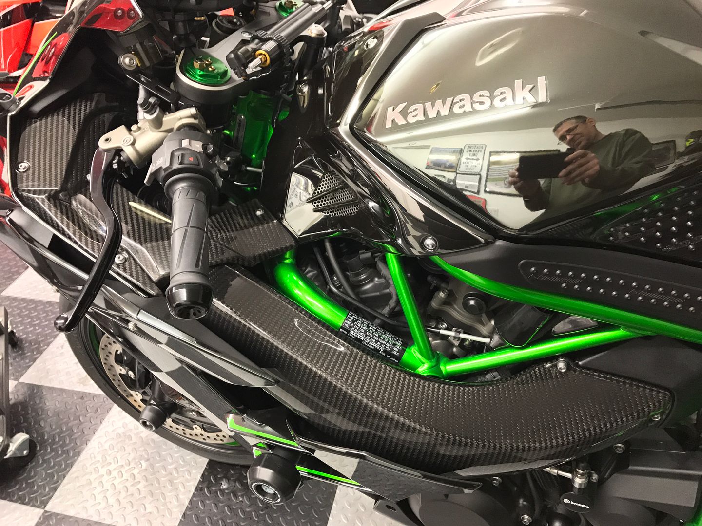

Pulled out the OEM bolt grommet out of the ram air tube (that the middle of part that the fairing mounts to) installed it to the CF tube. Pulled out the OEM ram air tube rubber gasket that sits against the filter box & put it on the CF part. The ram air tube fit perfectly, the inlet size was perfectly matched to OEM, so was the placement of the filterbox bolt holes. The dash panels also lined right up with the bolt holes, they don't have the OEM post underneath that pushes into the rubber grommets but are totally secure. Anyway here's some pics, took some shots of the inside & underside (can tell it's not peel ply) of the CF as well. I'm really happy w/ this co.'s parts & highly recommend them to anyone looking for CF.
Here's the chain guard spacer/washer that I dremeled down to fit, only took a few minutes:
